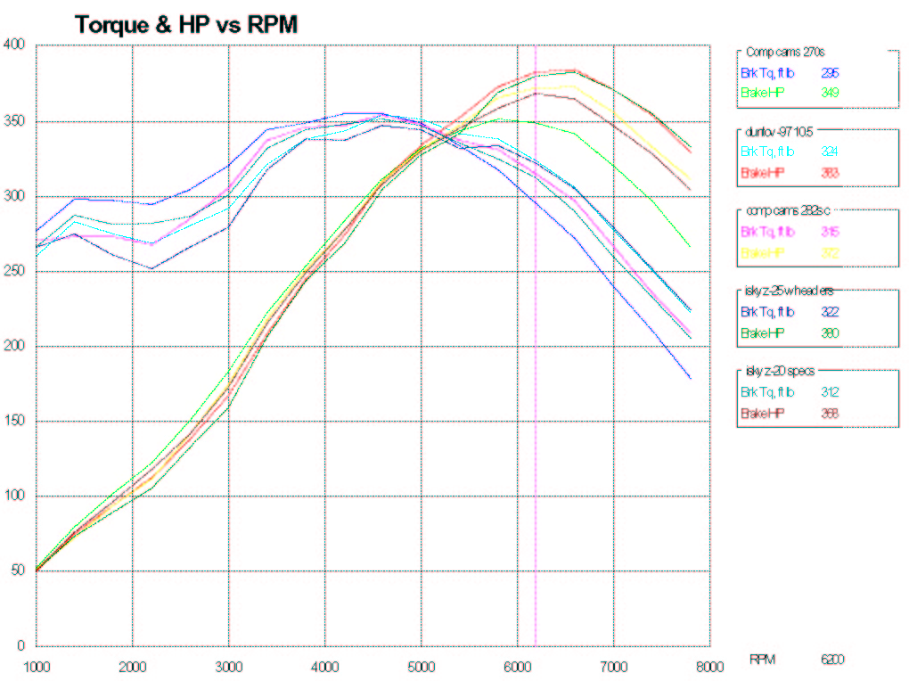

Been working on cam choices for the last few weeks, trying to determine which cam to use.... Looks like the Duntov -97 is the winner...
Pk TQ = 354@4600 RPMs Avg 302
Pk HP = 384@6600 RPMs Avg 253
What do you goes think ??? ..... (IMG:http://www.914world.com/bbs2/html/emoticons/happy11.gif)
