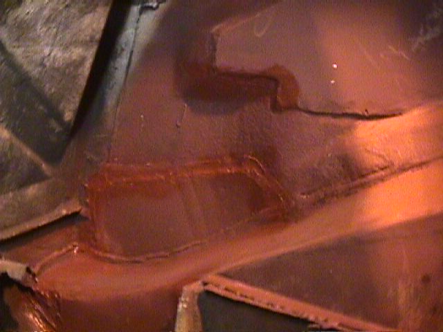

tracks914   Here is a picture of what I had to cut out. With t...   Sep 18 2003, 08:10 AM
tracks914   And after the repair.   Sep 18 2003, 08:12 AM
tracks914   And after that....   Sep 18 2003, 08:12 AM
tracks914   Just wait, I love doing this... and after that... ...   Sep 18 2003, 08:13 AM
