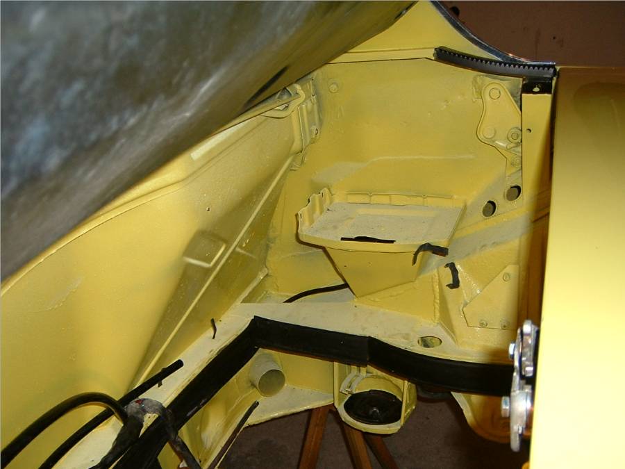

How does one inspect the hell hole looks like you can't see much from up on top.
Geoff looked at mine quickley but I would like to dig a little deeper. Any suggestions

SirAndy   take the battery and brain out and get some good l...   Sep 17 2003, 02:15 PM
J P Stein   I stick my hand down in there.....and have the sca...   Sep 17 2003, 02:51 PM
reverie   I need to do that, too.. have a good look from abo...   Sep 17 2003, 04:30 PM
SirAndy   also, more often than not, it is rusted through th...   Sep 17 2003, 04:41 PM
SirAndy   and the final result, just ingore the sand, this p...   Sep 17 2003, 04:44 PM

Neal   I ventured into the Hell Hole and found it only th...   Sep 17 2003, 06:20 PM
Neal   P.S all the metal except the hole is sound, I poke...   Sep 17 2003, 06:22 PM
SirAndy   patch it. you don't want anymore stuff falling...   Sep 17 2003, 06:36 PM
Hawktel   I think the issue is what does the behind that hol...   Sep 17 2003, 06:44 PM
SirAndy   <...   Sep 17 2003, 06:46 PM

Neal   Please give me a tutorial on "cut it out" and what...   Sep 17 2003, 09:46 PM
SirAndy     Sep 17 2003, 10:05 PM
reverie   Neal, it might be cost-effective to ask a local sh...   Sep 17 2003, 10:11 PM
Bleyseng   It would be better to trash the tray and support s...   Sep 18 2003, 07:53 AM
tracks914   Here is a picture of what I had to cut out. With t...   Sep 18 2003, 08:10 AM
tracks914   And after the repair.   Sep 18 2003, 08:12 AM
tracks914   And after that....   Sep 18 2003, 08:12 AM
tracks914   Just wait, I love doing this... and after that... ...   Sep 18 2003, 08:13 AM

mr914   Photo of mine before repair.... Still have much ...   Sep 18 2003, 10:30 AM
Neal   My tray is new, that is what caused this problem B...   Sep 18 2003, 12:37 PM
J P Stein   My battery tray is new, also. It just ain't he...   Sep 18 2003, 12:44 PM
Brad Roberts   Damn how did you get those self tapping screws int...   Sep 18 2003, 12:49 PM
reverie   Neal and 914NNP, You might want to use John Kelly...   Sep 18 2003, 12:55 PM
