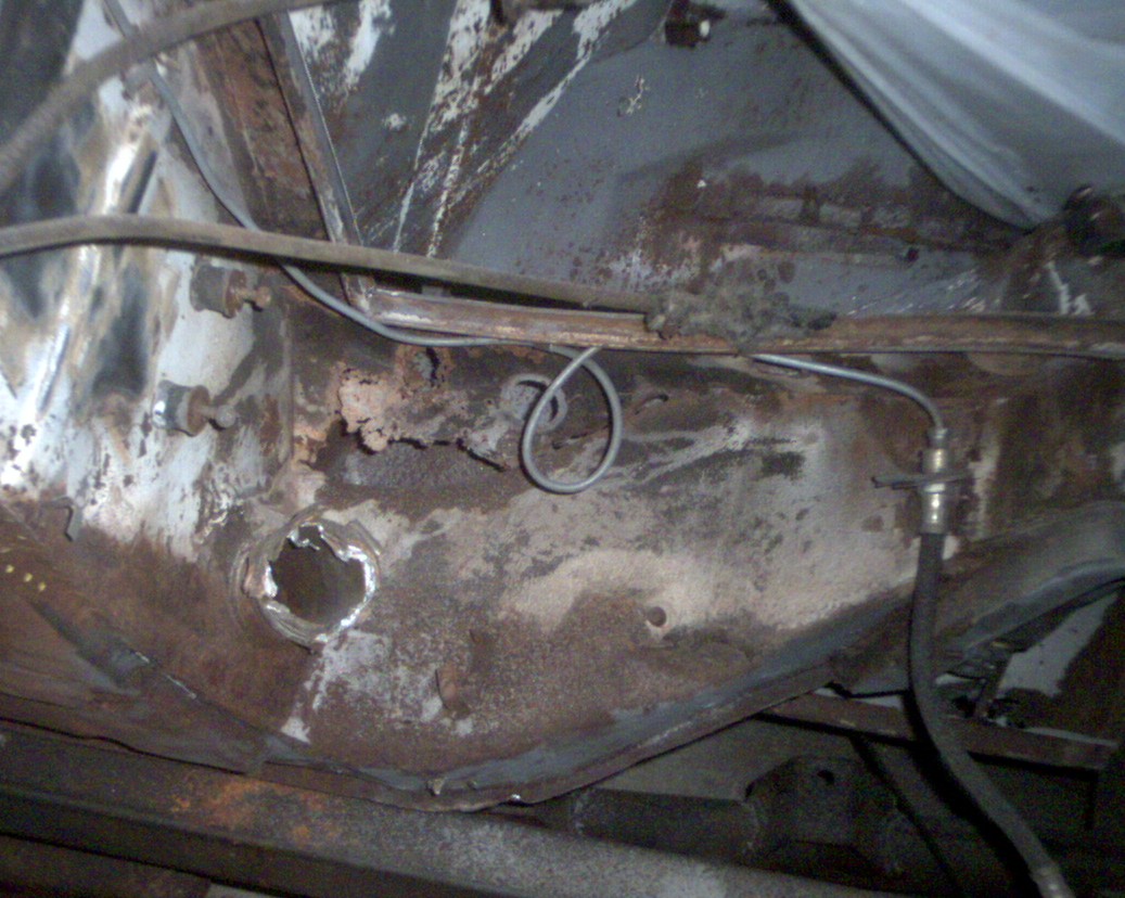

How does one inspect the hell hole looks like you can't see much from up on top.
Geoff looked at mine quickley but I would like to dig a little deeper. Any suggestions

Photo of mine before repair....
Still have much (IMG:style_emoticons/default/smash.gif) (IMG:style_emoticons/default/smash.gif) in other areas.

Neal   I ventured into the Hell Hole and found it only th...   Sep 17 2003, 06:20 PM
Neal   P.S all the metal except the hole is sound, I poke...   Sep 17 2003, 06:22 PM
SirAndy   patch it. you don't want anymore stuff falling...   Sep 17 2003, 06:36 PM

Neal   Please give me a tutorial on "cut it out" and what...   Sep 17 2003, 09:46 PM

reverie   Neal, it might be cost-effective to ask a local sh...   Sep 17 2003, 10:11 PM
Bleyseng   It would be better to trash the tray and support s...   Sep 18 2003, 07:53 AM
tracks914   Here is a picture of what I had to cut out. With t...   Sep 18 2003, 08:10 AM
tracks914   And after the repair.   Sep 18 2003, 08:12 AM
tracks914   And after that....   Sep 18 2003, 08:12 AM
tracks914   Just wait, I love doing this... and after that... ...   Sep 18 2003, 08:13 AM
914NNP   reverie Please tell me more about the Mercer Islan...   Sep 18 2003, 09:02 AM
mr914   Photo of mine before repair.... Still have much ...   Sep 18 2003, 10:30 AM
Neal   My tray is new, that is what caused this problem B...   Sep 18 2003, 12:37 PM
