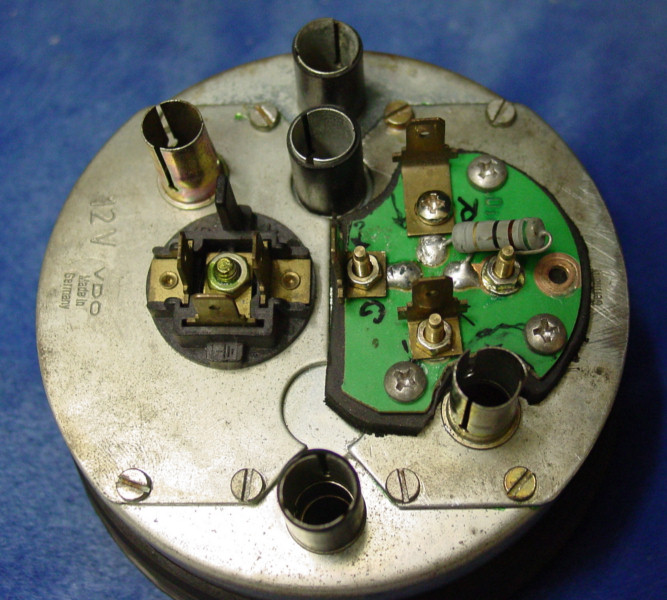

Front:
bondo
post Apr 7 2006, 11:39 PM
Posts: 4,277
Joined: 19-April 03
From: Los Osos, CA
Member No.: 587
Back: (IMG:http://www.914world.com/bbs2/html/emoticons/cool.gif)
It's just the guts of a generic water temp gauge hacked into the stock (911) housing, with the stock needle. 180F is dead center.
