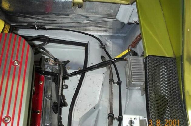

Bleyseng   A shot of my hell hole all purdy....   Sep 17 2003, 05:32 PM
