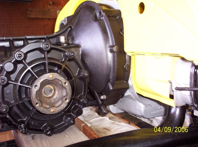

I'm having a similar "issue" as well...
Installed the tranny today on my new longblock/ with sachs clutch pack.
Only to find that when I move the clutch fork, the t/o bearing will not engage the clutch (IMG:http://www.914world.com/bbs2/html/emoticons/blink.gif) (IMG:http://www.914world.com/bbs2/html/emoticons/blink.gif)
Guess I'll pull it back off, look to see how many shims are
installed, & use the torch if I have too. Thanx -
A couple picz -
