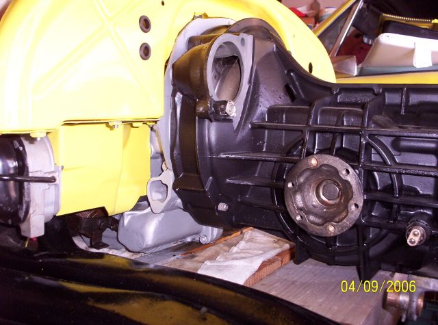

SirAndy     Apr 9 2006, 02:56 PM
"7"     Apr 9 2006, 03:02 PM
"7"   nother -   Apr 9 2006, 03:03 PM
SirAndy     Apr 9 2006, 06:02 PM
