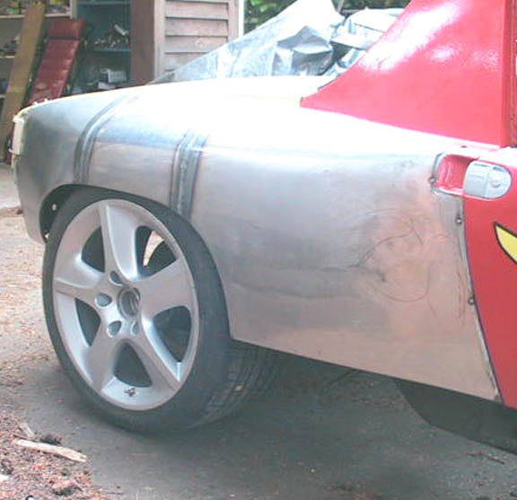

The 2000 Audi S4 drivetrain fits with no major interference issues except where the stock intercoolers mount on either side of the engine. In the 914 this is the location where the "shelf" is located. I was wondering if I can cut the sidewall to the inside of the flare where I planned to mount these intercoolers. Would this significantly weaken that area? I actually would like to cut more than hatched area...

The other question is efficiency of air management. I plan to mount them low inside the fender ahead of the rear wheels

neo914-6 ...with an intake (maybe bigger than pictured) to ... Apr 15 2006, 12:09 AM
Aaron Cox maybe use a strong webbing/net to weld in the open... Apr 15 2006, 12:10 AM
914_1.8t Have you thought about mounting them where you hav... Apr 15 2006, 02:23 AM
