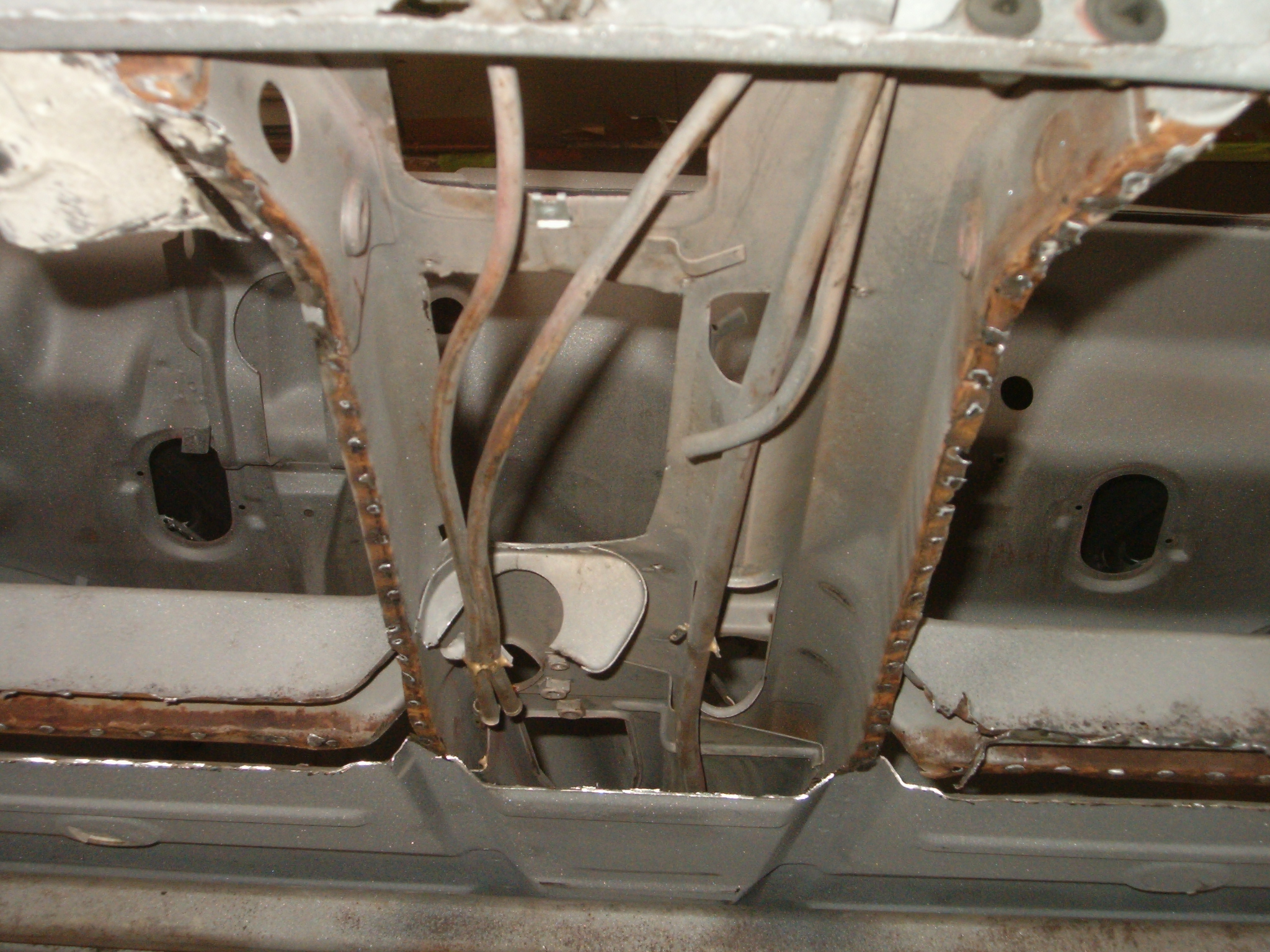

I will try one LARGE picture and see how it works.
underside of tunnel, floor gone. he also fixed the area where the tubes pass through the hole that is not supported by welding that all up before he put the new floor on.
