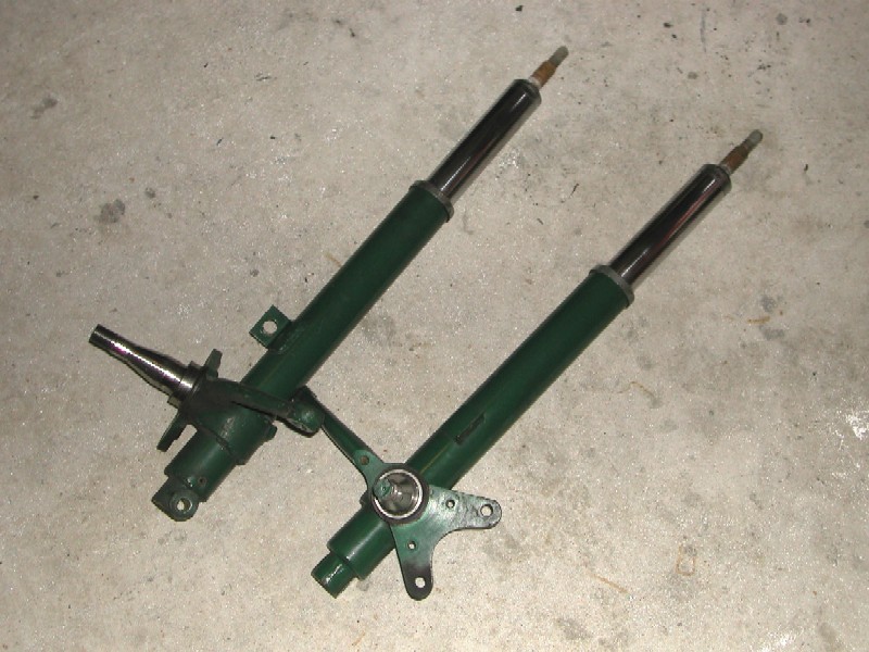

Okay... spent about an hour stripping the front suspension down to the Bilstein struts. They will be sent off to have the spindles raised and the inserts revalved.
I disassmbled the hub in preparation for new bearings and shorter studs (there was a spacer and longer studs installed from the PO). Attached image(s)
