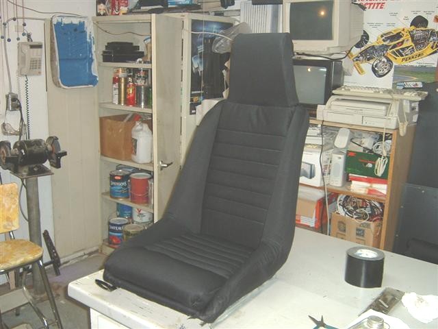

I have never been a fan of the comfort afforded me when I drive my car. I have found that Rabbit or Jetta seats to offer better latteral support and just being made of fabric you don't tend to slide around.
So the winter project started with an old 914 seat I had lying around.
First I built up the side bolsters 2" in the middle, 1" 1/2 way up and forward tapering to 1/4" at each end. Picture # 1Attached Image

Then I bought some Neoprene on Ebay, took the old seat apart, matched as many seams as I could to the new material.
Then I sewed it all together.
