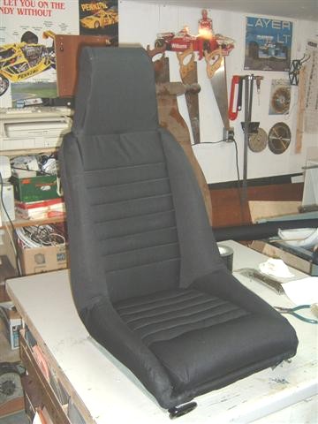

I have never been a fan of the comfort afforded me when I drive my car. I have found that Rabbit or Jetta seats to offer better latteral support and just being made of fabric you don't tend to slide around.
So the winter project started with an old 914 seat I had lying around.
First I built up the side bolsters 2" in the middle, 1" 1/2 way up and forward tapering to 1/4" at each end. Picture # 1Attached Image

robby750   I like it! Good job!   Apr 17 2006, 07:58 PM

anthony   Cool project!   May 9 2006, 08:46 PM
tracks914   These ones cost me about $50 in material and ...   May 17 2006, 02:30 PM
Andyrew   I had plans on doing that. Looks great!! ...   May 17 2006, 02:32 PM
