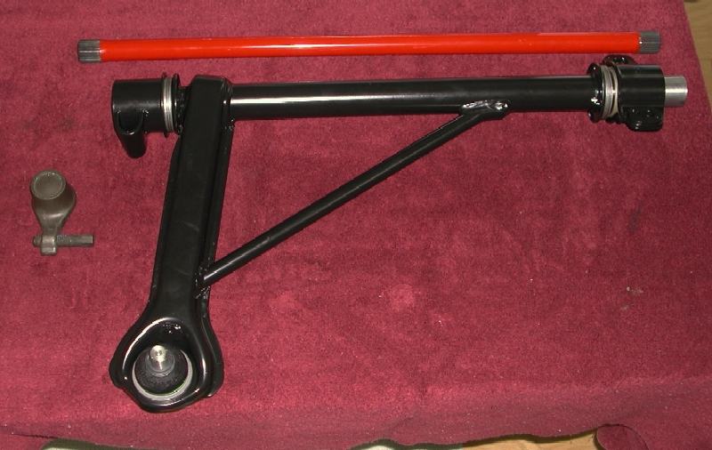

Got Mueller's needle bearing installed on the right side a-arm. It required some sanding of the ends to get the sleeves to fit and then heating the sleeves in the oven to expand them.
22mm torsion bar from Smartracing (Sway-away power bar) is sitting there, as well as the new ball joint!
The driver's side is in progress and is turning out to be a little harder than the first side.
What fun! (IMG:style_emoticons/default/w00t.gif)
