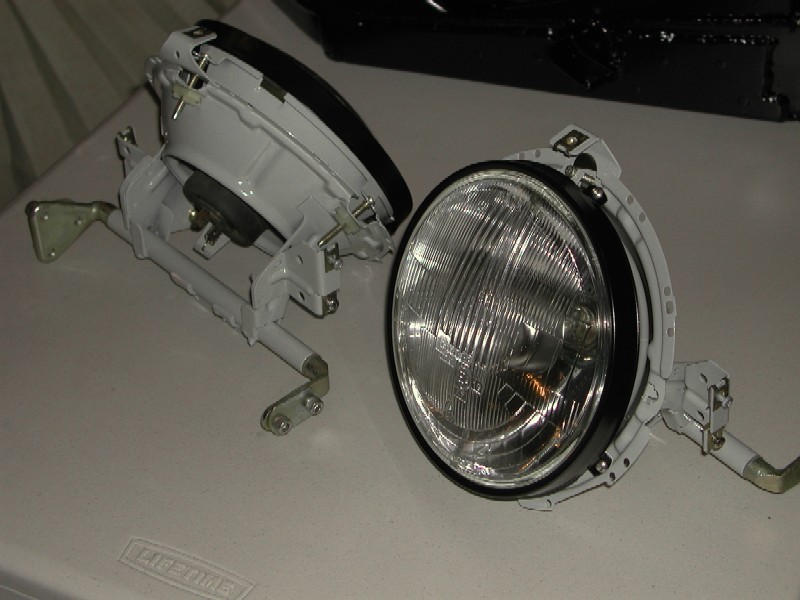

Busy day...
Finished installing the NOS Cibie headlights in the front bucket assemblies (had the headlight ring powdercoated).
