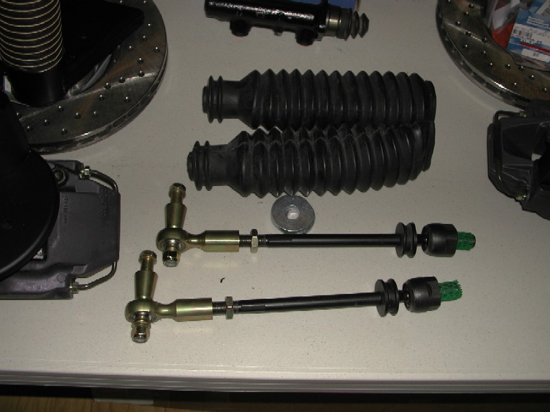

Installed the ERP bump steer kit on the tie rods.

Qarl   Installed the ERP bump steer kit on the tie rods.   Sep 20 2003, 11:45 PM
Brad Roberts   You are going to hate yourself. You dont need that...   Sep 21 2003, 05:12 AM
Qarl   AAhhhh... what you are looking at is the result of...   Sep 21 2003, 09:14 AM
