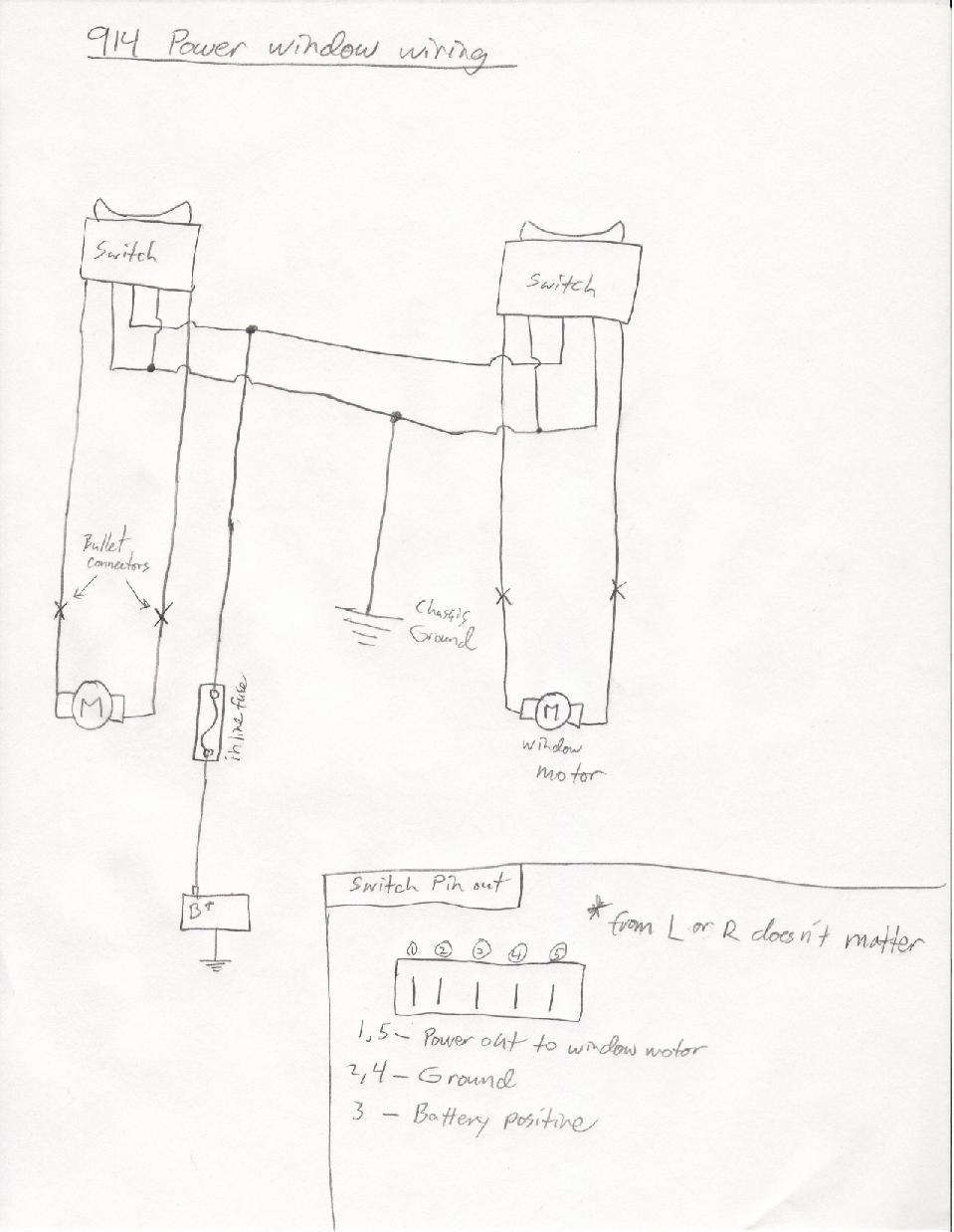

Alrighty, here are the wiring instructions in free hand. The switch does not care if you hook it up one way or another since it is symetrical (IMG:style_emoticons/default/biggrin.gif) Any questions, just post here and I will get to them.

Dr Evil   Alrighty, here are the wiring instructions in free...   Apr 23 2006, 08:49 PM
jim_hoyland   Mike, Is the diagram pretty much the same as the ...   May 2 2006, 10:29 PM
Dr Evil   Yup, the diagram is based on if you want ot run tw...   May 3 2006, 09:50 AM
jim_hoyland   Mike, Installed the switches today, found some re...   May 6 2006, 06:25 PM
