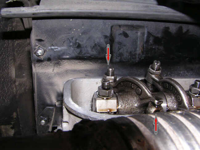

I couldn't find Mile's drawing of a cam (it magically made everything make sense to me) so, I decided to try my hand at it.
First, jack the car up so it assumes the usual and comfortable position of a 914. Resting securely on jackstands. I won't get under it without jackstands cause the thing jumps off of jacks. I have a dented long on the driver's side and a dented rocker panel on the other side to prove it
Dave

Check #3 exhaust.
DNHunt   My shot at explaining valve adjustment on a 4 pot   May 20 2006, 08:10 PM
DNHunt   Get under the car and remove the valve covers. I...   May 20 2006, 08:14 PM
DNHunt   Here's what you will see. The rocker assembly   May 20 2006, 08:15 PM
DNHunt   The whole process works because the flat aircooled...   May 20 2006, 08:25 PM
DNHunt   As a practical matter lock a road wheel so it will...   May 20 2006, 08:33 PM
DNHunt   I start by watching #2 exhaust and turing until it...   May 20 2006, 08:37 PM
DNHunt   On the opposite side of the engine #4 exhaust valv...   May 20 2006, 08:47 PM
DNHunt   Next rotate the engine until #2 intake is open. Se...   May 20 2006, 08:52 PM
DNHunt   Adjust #4 intake cause it is on the valve seat and...   May 20 2006, 08:54 PM
DNHunt   Rotate until #1 intake is open.   May 20 2006, 08:55 PM
DNHunt   Adjust #3 intake   May 20 2006, 08:56 PM
DNHunt   Rotate a gain until #1 exhaust is open.   May 20 2006, 08:57 PM
DNHunt   Adjust #3 exhaust   May 20 2006, 08:58 PM
DNHunt   Now block the other wheel so you can check the opp...   May 20 2006, 09:00 PM
DNHunt   Check #4 exhaust for full openning   May 20 2006, 09:01 PM
DNHunt   Adjust #2 exhaust   May 20 2006, 09:02 PM
DNHunt   Check #4 intake for full open.   May 20 2006, 09:03 PM
DNHunt   Adjust #2 intake   May 20 2006, 09:04 PM
DNHunt   Ditto for cylinder #3 intake and exhaust. Rotate u...   May 20 2006, 09:06 PM
DNHunt   Adjust #1 intake   May 20 2006, 09:07 PM
DNHunt   Check #3 exhaust.   May 20 2006, 09:07 PM
DNHunt   Adjust #1 exhaust.   May 20 2006, 09:08 PM
DNHunt   Tighten everything and check the valve cover gaske...   May 20 2006, 09:10 PM
DNHunt   I suppose this is a bit of urban myth but, I'v...   May 20 2006, 09:12 PM
