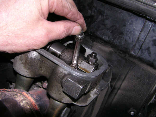

Adjust #1 exhaust.

DNHunt   Adjust #1 exhaust.   May 20 2006, 09:08 PM
DNHunt   Tighten everything and check the valve cover gaske...   May 20 2006, 09:10 PM
