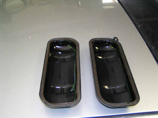

Tighten everything and check the valve cover gaskets. I reused these cause they are in good shape but, I always travel with a pair.
