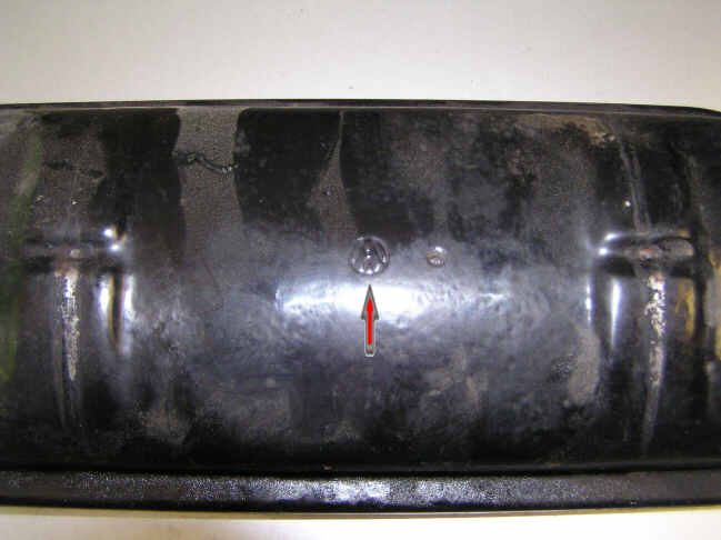

I suppose this is a bit of urban myth but, I've always been told that the VW logo goes upside down when you install the valve covers.
