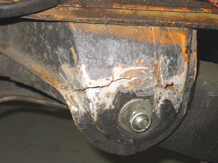

The owner of this car was recently at Watkins Glen. Then he noticed something wrong with the handling and with the toe of the left rear tire at his last autocross. By the time the car was unloaded at my shop this is what he was driving with.

I took a look across the engine compartment and here's what I saw. (IMG:style_emoticons/default/sad.gif)

root   what kind of bushings are behind there? new nylon ...   Jul 24 2006, 07:49 PM

brant   I tore 2 of these (both right hand sides) in appro...   Jul 24 2006, 11:00 PM
brant   and from below:   Jul 24 2006, 11:01 PM
trekkor   This is on top of my list this winter. :welder: ...   Jul 24 2006, 11:27 PM

Racer Chris   I took a look across the engine compartment and he...   Jul 26 2006, 06:58 AM
Racer Chris   bottom side detail   Jul 26 2006, 06:59 AM
Racer Chris   Repairs to the driver's side are underway. I c...   Jul 26 2006, 07:01 AM
Racer Chris   This piece had some perf but it is a lot easier to...   Jul 26 2006, 07:07 AM
Racer Chris   Back on the car... I pushed the lower portion back...   Jul 26 2006, 07:10 AM
Racer Chris   After the repair is complete I will be welding on ...   Jul 26 2006, 07:14 AM
ynotdd   Chris looks like you are doing a great job!...   Jul 27 2006, 07:00 AM
thesey914   When the inside is coated with por15 can it be wel...   Jul 27 2006, 11:42 AM
