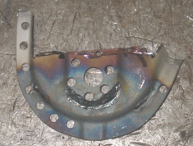

This piece had some perf but it is a lot easier to repair than replace.
The inner reinforcing layer was still good but the outer layer was badly rusted along the crack and around the bottom edge of the trailing arm mounting surface.
All the perf is filled with weld and the cracked area cut away.
This can be rewelded onto the car after just a little clean up.
