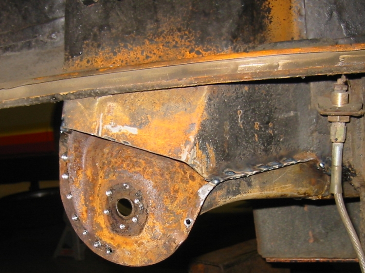

The owner of this car was recently at Watkins Glen. Then he noticed something wrong with the handling and with the toe of the left rear tire at his last autocross. By the time the car was unloaded at my shop this is what he was driving with.

Back on the car...
I pushed the lower portion back into place and welded it up along the forward pinch weld flange.
I also cut away the rusted area near the crack.
The next step is to wire brush the inside and coat with POR 15 before welding the small piece back on.
