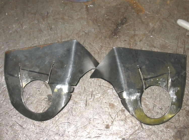

The owner of this car was recently at Watkins Glen. Then he noticed something wrong with the handling and with the toe of the left rear tire at his last autocross. By the time the car was unloaded at my shop this is what he was driving with.

After the repair is complete I will be welding on these reinfofcing pieces.
I also plan to make similar pieces available for others to reinforce this often overstressed part of the rear suspension.
