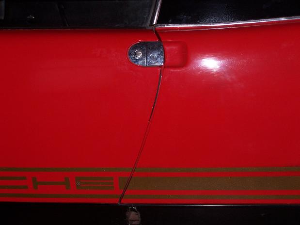

I want to paint the sails on my 914 a flat or satin textured black has anyone done this and if so what kind of paint did you use?

I painted my sails first with a "hammered" paint I believe from Rustoleum, followed by a regular gloss black since the hammered paint did not have a jet-black color. The hammered paint gives the sails a finish similar to the original vinyl covering.
Spoke Attached image(s)
