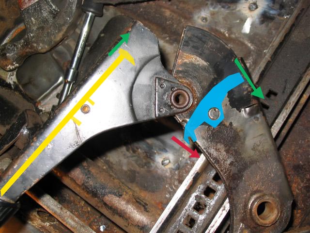

OK, my hand brake has always worked by friction, and the ratchet has only ever engaged once (on the freeway, stuck in traffic, embarassing). I need to get it working right to pass the Roadworthy inspection when I finally register the 914.
So, how does the early lever work to engage the ratchet? Should there be a spring in there? (other than the sping on the push rod)
Has anyone got a photo of the parts? PET doesn't really show it too clearly.
Thanks.

OK, when the button is pressed, the pushrod (yellow) pivots the ratchet (blue) in the direction of the green arrow.
When the button is released, what pushes the ratchet back in the direction of the red arrow to engage the quadrant (not shown)?
Mine is just loose to move. Am I missing a spring somewhere?

Cap'n Krusty   The pushbutton has a rod with a flat curved piece ...   Jul 27 2006, 06:18 PM
tat2dphreak   ... OR just get a late handle and convert...   Jul 27 2006, 06:38 PM
lapuwali   Cap'n, can you point out which part you're...   Jul 27 2006, 06:50 PM
Cap'n Krusty   7-10, item 3. I wouldn't waste more than abou...   Jul 27 2006, 07:07 PM
JPB   MIne is a 71 and just has the push rod straight to...   Jul 27 2006, 07:08 PM
Rick_Eberle   So the push rod should move the ratchet in AND out...   Jul 27 2006, 07:19 PM
JPB   Yesser, all it does is disengage the ratchet. Its...   Jul 27 2006, 07:30 PM
lapuwali   Well, I'm definitely not missing the push rod ...   Jul 27 2006, 07:49 PM
Rick_Eberle   OK, when the button is pressed, the pushrod (yell...   Jul 27 2006, 08:52 PM
lapuwali   Rick, that's exactly how mine is. I'm com...   Jul 27 2006, 09:50 PM
McMark   Perhaps the pawl is supposed to be free enough to ...   Jul 27 2006, 10:58 PM
lapuwali   Mine flops around very loosely. Gravity doesn...   Jul 27 2006, 11:33 PM
banksyinoz   hi rick glenn here have you ever taken notice of t...   Jul 28 2006, 02:59 AM
