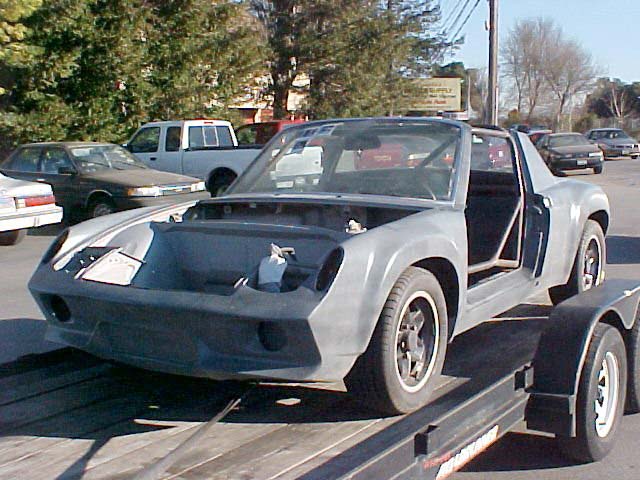

getting tired of my rants about sandblasting? yes? well, too bad because here is:
another reason *not* to sandblast your car !!!
pic of the rear wheel bearing from the trailing arms we just took off my car. you can hear the sand crunching inside when you turn it by hand ...
(IMG:style_emoticons/default/icon8.gif)
i HATE sandblasting ...
(IMG:style_emoticons/default/headbang.gif) Andy

s u u u r e ... (IMG:style_emoticons/default/blink.gif) how about, in the future, you read a post first before you answer? (IMG:style_emoticons/default/biggrin.gif)
i never said that "the wheels" were sandblasted. like mentioned above, the whole car was blasted and i left the suspension on the car so it could be rolled around.
as far as i know, the blaster never even came close to the wheels, as the trailing arms and the wheels did not show any signs of blasting ...
my point is simple, that stuff get's in *everywhere* but does not come out nearly as easy as it get's in.
in fact, just in the last 2 weeks, i ended up using the dremel to *make holes in my car* just to get the trapped sand out of it.
that is, almost FOUR years after the blasting ...
(IMG:style_emoticons/default/icon8.gif) Andy
