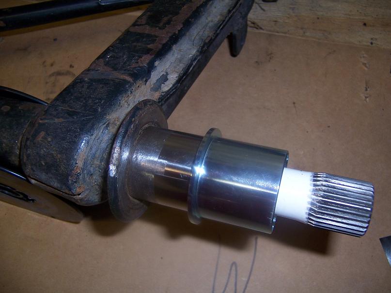

Here I'm using a .001" and a .002" shim to snug up the fit. I didn't get any pictures of the operation but from here you just slide the sleeve all the way onto the bearing surface untill it's firmly bottomed against the flange. I had to straighten up the flange a little to get good contact with the sleeve.
After that I used the Loctite product specified in the instructions. About 5 to 7 drops. It wicked into the seam real slick.
