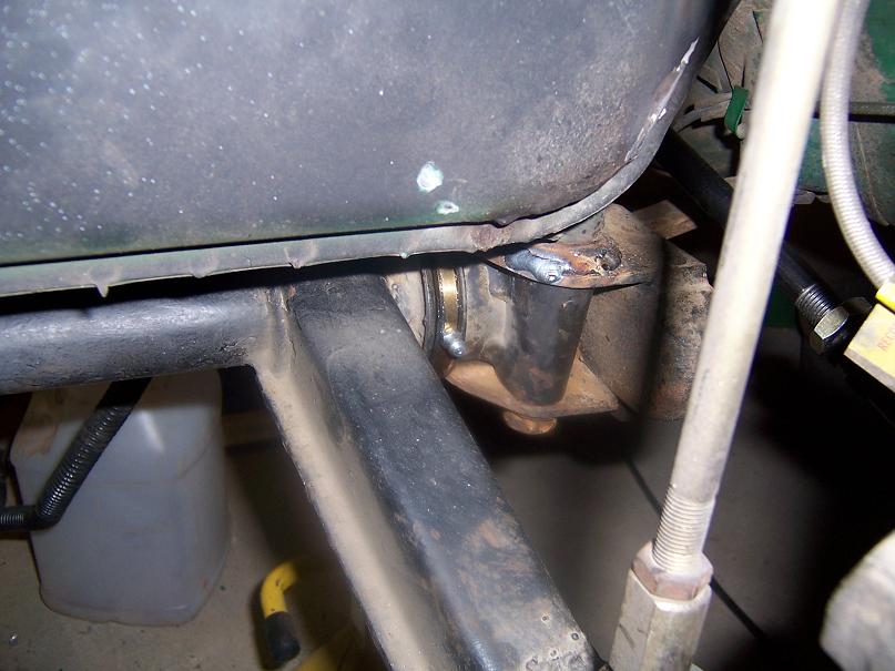

The finished installation.
I let it set up overnight to cure. I tried to remove it using all my strength with just my hand and it didn't budge. Here is the installed arm. Moves really smooth now. No "sticktion".
