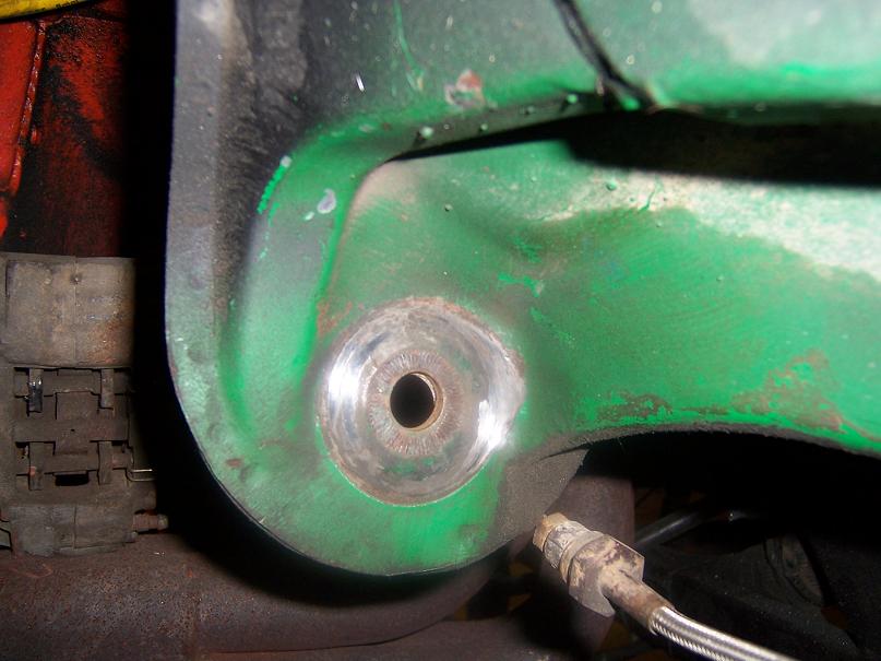

When I removed the rear trailing arms I found this: Looks like the Weltmeister Polygraphite bushings were rubbing the inner ear. No cracking or pulled seams though. No "ovaling" of the mounting hole.
