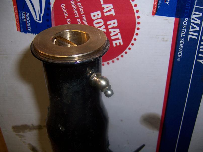

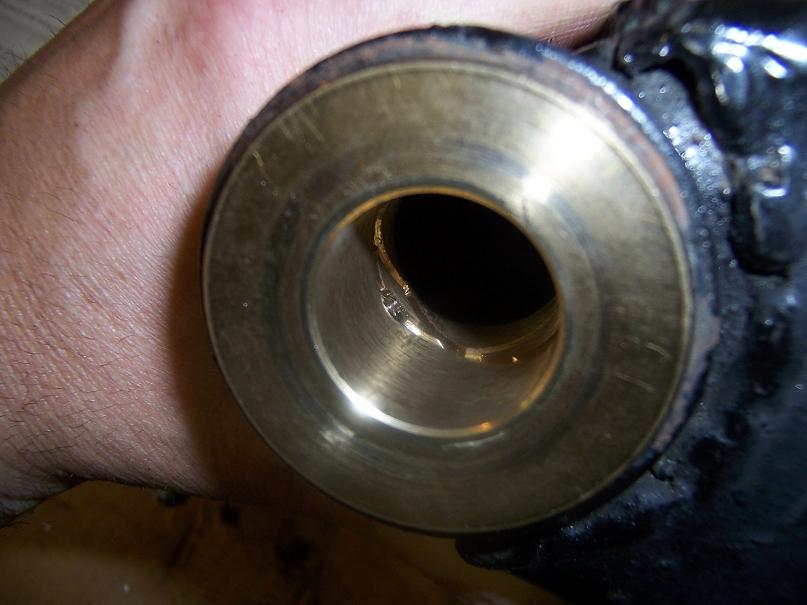

Measure over 15/16", drill straight and you nail the grease groove dead center. I used 45° 1/4-28 fittings instead of the 5mm that came with the kit. I had a 1/4-28 tap.
Grease fitting installed.

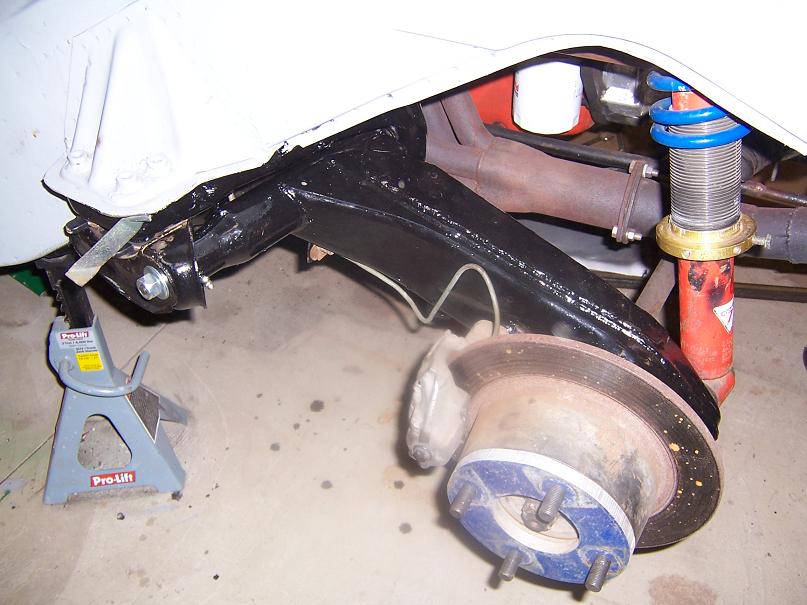

Here is the Rear trailing arm installed with the new PolyBronze Bushings and a fresh coat of POR-15.
