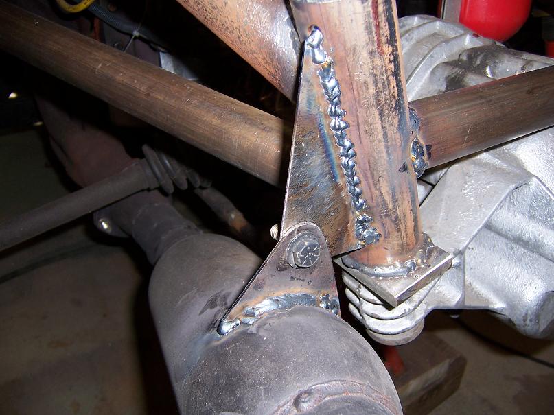

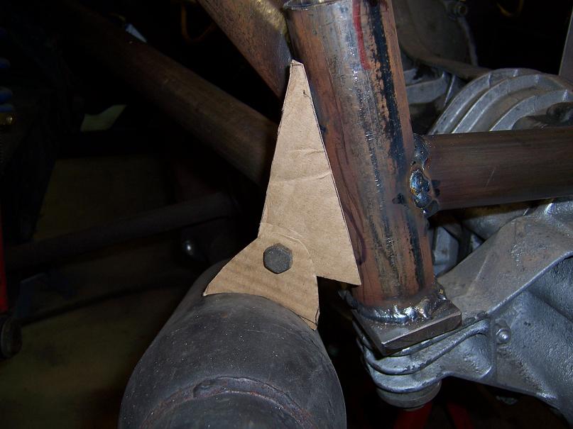

With the rear tail light panel cut away along with all the bodywork rearward of the shock towers I lost my exhaust system hanger. I supported the muffler on a jack and made up a template for a bracket.
transfered the template to flat .09" steel plate and cut out a 2 pc muffler hanger. I welded it directly to the upright and the Bullet muffler. Light and simple. Maybe I'll drill a few lightening holes in it...
