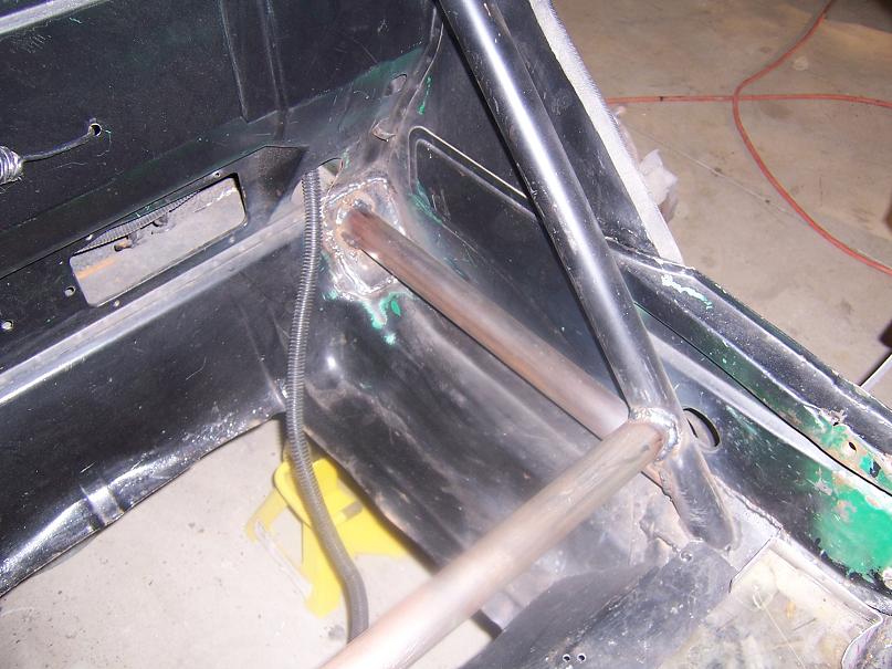

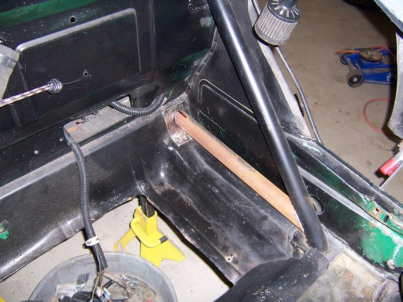

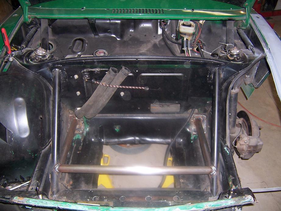

I repaired the bent nose by cutting away all the sheetmetal affected by the lousy repair job. With the front end sheetmetal cut away I needed to reinforce the front end.
I added bars from the existing angled tubing to the mounting area of the front suspension crossmember. I attached them to 1/8" steel plates to spread the load.
I added a crossbar to stiffen the front of the torsion bar mounts.
