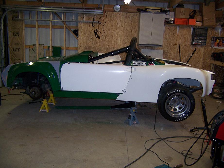

After a dismal performance plagued by random oversteer at my last AX I decided to that continuing to use the car in it's current state made no sense. I have been accumulating a bunch of suspension pieces and fiberglass body parts and decided that there was no time like the present to get to work.
This was the car on July 16th;

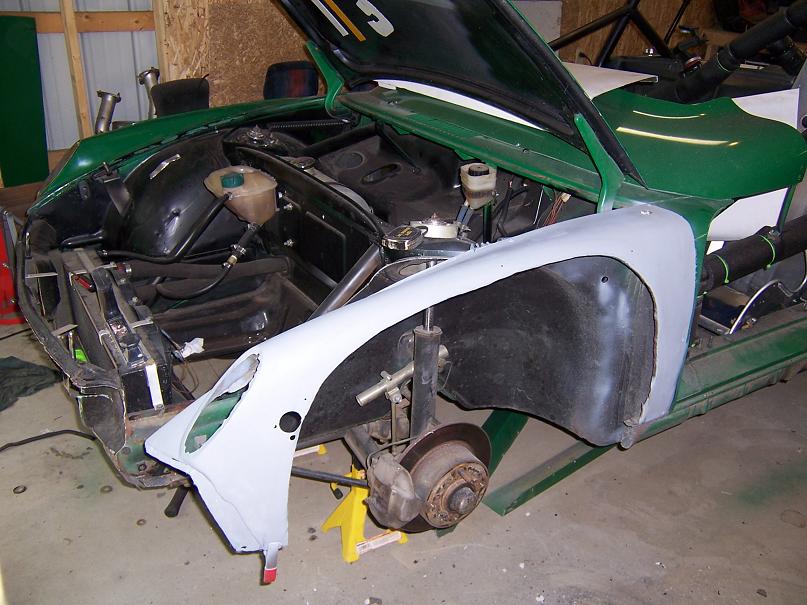

I replaced the entire front fender because it had been repaired by welding on a new front half with the seam just about centered over the tire. Whoever did it was careless and the front of the fender ended up 1" higher than the passenger side. I cut off the fender from a parts car and installed it in the proper location.
These will be replaced with fiberglass 1/4's when my budget recovers.
GT Racing 1/4 panel, Rennspeed Fiberglass doorskin. Retained with DZUS type fasteners.

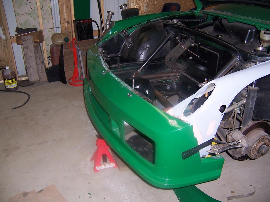

Front IMSA Airdam fastened in place with 5 DZUS plates across top edge.
