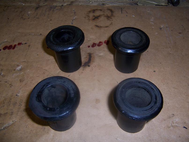

Here are the Weltmeister Polygraphite bushings I took out of the rear after 9 years of service and hundreds of autocrosses. Look at the odd wear pattern in the ones on the left. There is also evidence that they deformed a little.

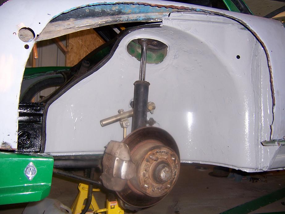

Front end reassembled with 22mm Welt torsion bars, 22mm Welt sway bar. I added Turbo tie rods this time around.
That pretty much brings things up to date. Still have a bunch of assembly to do. Then set ride heights and set camber, caster, toe etc.
