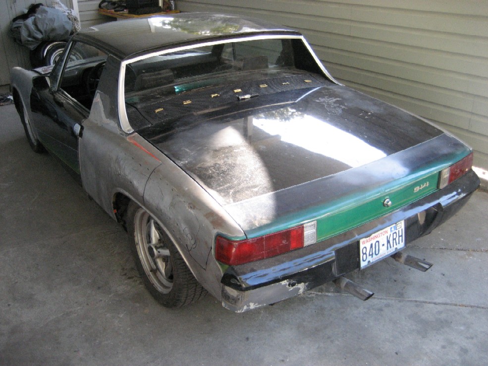

started out by stripping all four corners about a month ago, then bought my fuches, but since then I have kinda stalled out mostly due to work obligations, had to go to NE Washington for the forest fires for the last three weeks or so.
before I left I bought 16x6 and 7's and found that some stretching would be necessary in the rear. I have always liked soft flares anyway... but as follows is 1) as delivered
2-4) stripped and pounding started on the rear fenders

#2 stretched

JPB   Lots of stroking on that sheet metal bro. Good wo...   Sep 9 2006, 07:21 PM
geniusanthony   #4 close up again...and problem area which i need ...   Sep 9 2006, 07:23 PM
geniusanthony   dont worry i know i am not close to being done (bu...   Sep 9 2006, 07:28 PM
Lou W   Looking good, looks like you'll end up with so...   Sep 9 2006, 07:34 PM
geniusanthony   my goal is more rounded to flow into the shoulders...   Sep 9 2006, 07:54 PM
Lou W   No, its not mine...however there are people here t...   Sep 9 2006, 07:57 PM
geniusanthony   BUMP   Sep 10 2006, 04:37 AM
JPB   If you use a brazing tip on a torch and the samlle...   Sep 10 2006, 06:14 AM
John Kelly   Hi Tony, You need to use a hammer and dolly to sm...   Sep 10 2006, 07:20 AM
geniusanthony   John, thank you for your quick reply to my earlier...   Sep 12 2006, 03:26 AM
geniusanthony   side note all I am trying to intall in the rear is...   Sep 12 2006, 10:24 PM
John Kelly   Hi Tony, It takes many stretch and smooth session...   Sep 13 2006, 08:06 AM
geniusanthony   haven't had the oppportunity to wokr lately or...   Sep 14 2006, 08:50 AM
