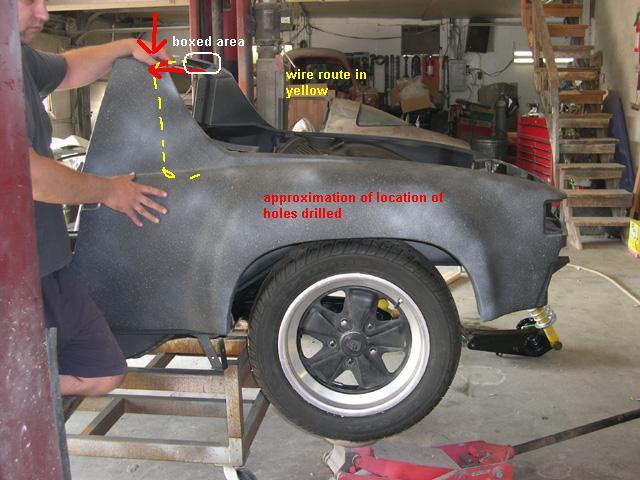

I will have to get more pictures form the body shop, but here is the short answer:
If you followed this thread, I had the entire trailing edge of the targa bar seam welded so I could have the targa bar body colored with no trim attached. After the seam welding, they cut a portion of the lower rear edge out and welded in a box with mounting nuts for the light. they ran a wire through the targa bar from the light box to the relay board area. To do this they had to drill an hole in the side of the targa bar to access the wire and then another in the top at right angles to the first to push it down into the engine compartment, and then weld up the holes. I will likely need to wire it with a relay, a 12 volt from the battery and a resister to get the proper brightness.
(BTW, the light is from a Del Sol, and as you can see is a perfect fit.) I would estimate that this was about 10 hours of labor at the shop, but if you have the skills it should be pretty cheap!

bmunday   Mark, How did you mount and wire the third light?...   Sep 11 2006, 09:31 AM
gopack   I will have to get more pictures form the body sho...   Sep 11 2006, 09:46 AM
