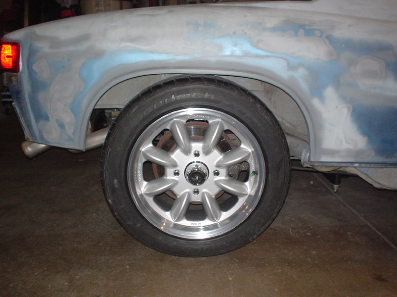

Bolt pattern: 4 x 130
Offset: +35 mm
Weight: 18.6 pounds - measured (website says 20.5 pounds)
I ordered 5 wheels with lugs, nuts, centercaps, and valve stems, and received a 5% discount from the website pricing.
The 16" wheels had to be ordered from Australia (waited a couple of months), since he did not have any in stock. I believe he is working on getting 16" stock and also has a driling machine to make various bolt patterns.
Tires: BF Goodrich G-Force Sport 205/55/16.
Diameter: 24.9" vs. 25.4" for a stock 165/16 tire (makes it 2% fast on the speedometer)
Width: 8.3"
Total weight: Dunno - forgot to weigh before installing. But probably around 35 pounds.
Fit: See pictures below.

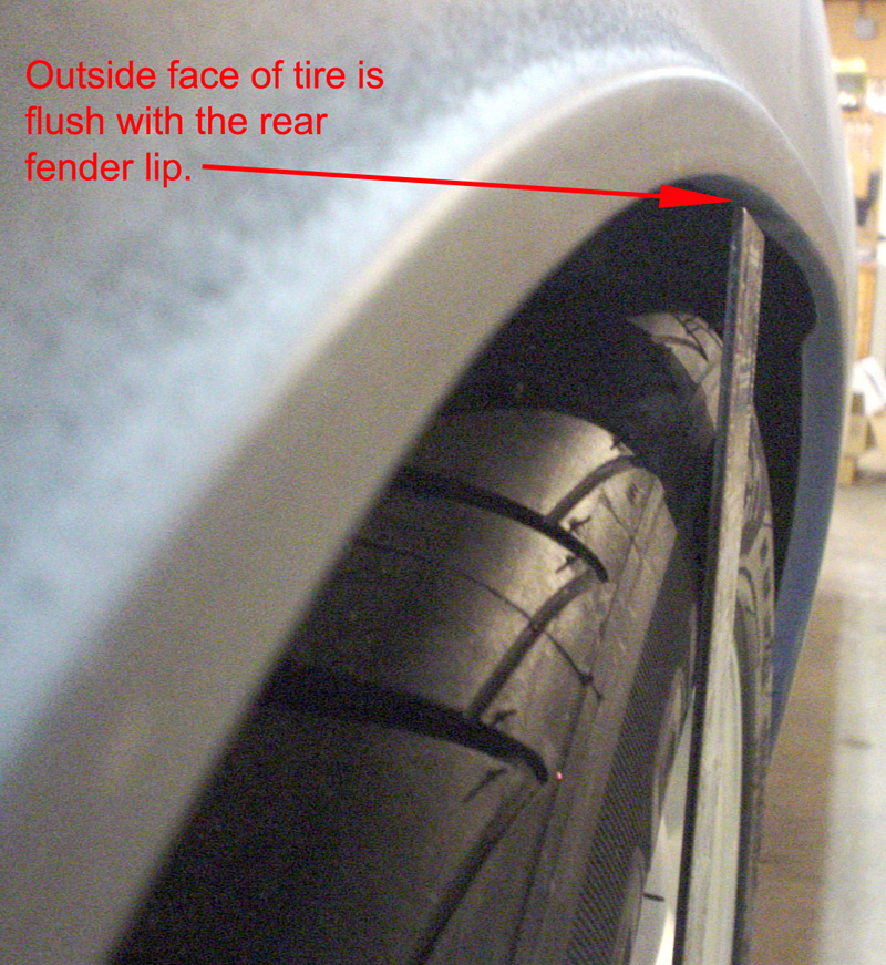

Rears: There is about 0.5" clearance on the inside at the inner fender wall and about the same at the swing arm. The exterior of the tire pretty much lines up with the inside fender lip. (Right side lines up and left side has about 1/6" clearance. This could be a problem if you have sagging springs and the fender lip is much below the top of the tire.
Fronts: There is about 1/4" clear at the front and back of each tire at full left and right wheel lock. There is less than 1/8" clearance at the strut cover.
