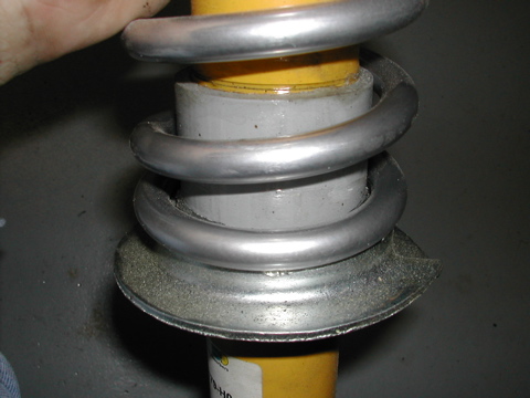

I added some 2.5" spacers to keep the springs center on the bilsteins. 14" springs means you can spin hte not down by hand to the last 1/2" turn, they you need a small wrench. This is with the collar at 1/2 way. My old 140lbs where also 14" long. But the problem is a 140 lbs spring will allwow the rear to sit a little lower than the 175 lbs will. Forgot that little detal. Yeap that is PVC Electrical conduit.

914forme   Stock Shock cap is ~4" Stock Spring Inside is...   Oct 8 2006, 03:37 PM
914forme   I added some 2.5" spacers to keep the springs...   Oct 8 2006, 03:40 PM
