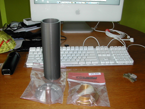

Colemann Parts came in (IMG:style_emoticons/default/boldblue.gif) I am off to the shop and see what I can figure out on the installation.

drew365   What is the diameter of the springs? If they are 2...   Oct 8 2006, 10:46 AM
URY914   You need to know the inside and outside diameters ...   Oct 8 2006, 10:49 AM
914forme   I am taking a set out of my car today, I will let ...   Oct 8 2006, 11:35 AM
nebreitling   those won't work unless you have aftermarket p...   Oct 8 2006, 01:11 PM
Aaron Cox   yep... 2.5 X length.. works with aftermarket perch...   Oct 8 2006, 03:31 PM
914forme   Stock Shock cap is ~4" Stock Spring Inside is...   Oct 8 2006, 03:37 PM
914forme   I added some 2.5" spacers to keep the springs...   Oct 8 2006, 03:40 PM
Aaron Cox   why not buy real coilover sleeves from coleman....   Oct 8 2006, 08:58 PM
nebreitling   i'm with aaron on that one... a spring that sl...   Oct 8 2006, 09:44 PM
Aaron Cox   its like 40 bucks per side to do it right...... y...   Oct 8 2006, 10:50 PM
914forme   I am way ahead of you guys, I ordered them all rea...   Oct 9 2006, 09:15 AM
914forme   Colemann Parts came in :boing: I am off to the sho...   Oct 9 2006, 02:57 PM
J P Stein   They can be installed properly (without the hat fl...   Oct 9 2006, 04:52 PM
Rough_Rider   Mini-tip: Don't wrench the zip ties down tight...   Oct 9 2006, 05:22 PM
914forme   Okay so did you heat the sleave in the oven or wit...   Oct 9 2006, 05:38 PM
