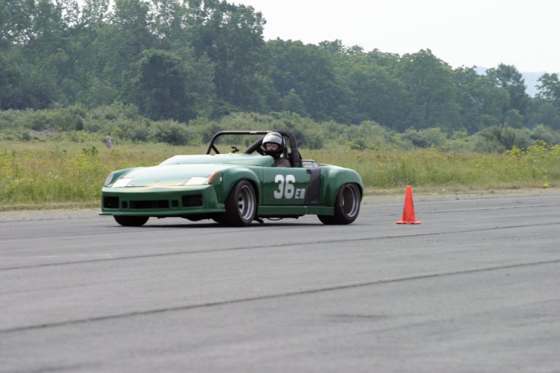

After a dismal performance plagued by random oversteer at my last AX I decided to that continuing to use the car in it's current state made no sense. I have been accumulating a bunch of suspension pieces and fiberglass body parts and decided that there was no time like the present to get to work.
This was the car on July 16th; Attached image(s)
