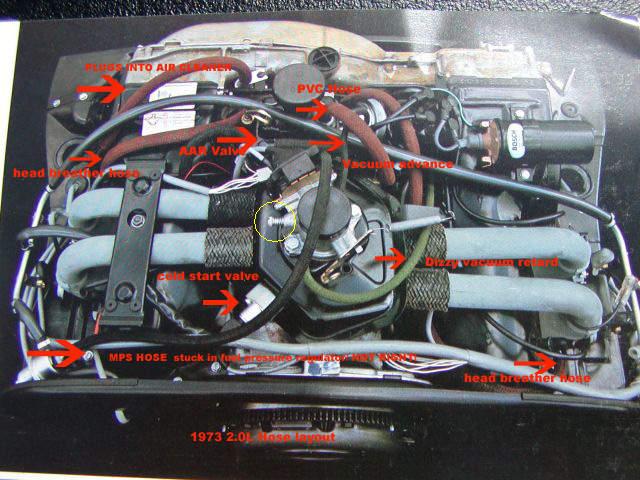

Here's a picture with the bleed screw circled in yellow, you see also where some other components of the FI are located like the AAR. And if you don't have a CO meter (neither do I) when you will be playing with the pot on the ECU, you'll see a marking on the knob and one the outer ridge, rule of thumb is that you have to be within 3-4 clicks either side from that marking since that was the factory adjustment.

Bleyseng   On the side of the throttle body is the air bleed...   Oct 12 2006, 10:37 PM
mihai914   Here's a picture with the bleed screw circled ...   Oct 13 2006, 06:45 AM
