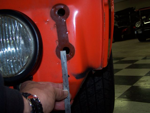

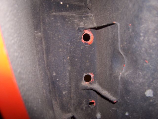

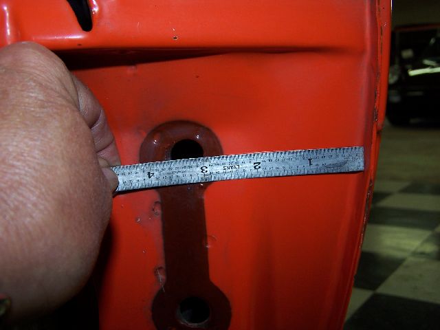

Is it possible to install an early bumper on a 1976? If so how is it done?
Don

A few more pics.

boxstr   Yes it can be done. You might try a search for the...   Oct 27 2006, 08:54 PM
porschecb   what! you don't like late style bumbers...   Oct 27 2006, 09:10 PM
So.Cal.914   The condom bumpers are heavier. There are four bol...   Oct 27 2006, 09:19 PM
Dave_Darling   I believe Paul means "rubber dog-bones",...   Oct 27 2006, 09:23 PM
dhopkins   I searched but found not a single thing. If I chan...   Oct 27 2006, 10:06 PM
jk76.914   I did it on my '76. I think it was worth it. ...   Oct 27 2006, 10:06 PM
boxstr   Well It looks like most of the process has been co...   Oct 27 2006, 10:34 PM

boxstr   A few more pics.   Oct 27 2006, 10:35 PM
boxstr   Last one....   Oct 27 2006, 10:37 PM
Bleyseng   Nice pics Craig! yep. its fairly easy to do a...   Oct 27 2006, 11:18 PM
So.Cal.914   The studs in the bumper are a great idea Craig. j...   Oct 27 2006, 11:45 PM
dhopkins   Thanks very much. Great job! How about the rea...   Oct 28 2006, 11:17 AM
