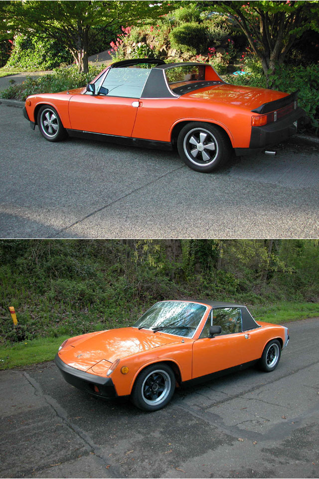

Is it possible to install an early bumper on a 1976? If so how is it done?

Nice pics Craig!
yep. its fairly easy to do and worth it.
