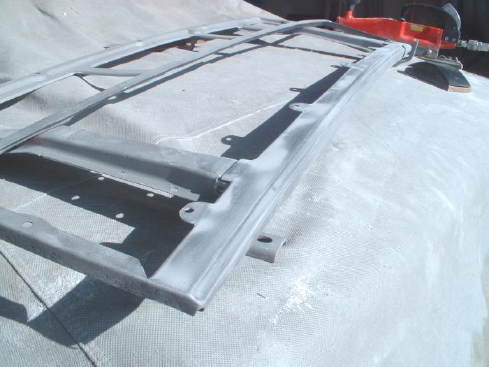

Finished off the filler on the rear strip. I also went out and got some black primer and black semi gloss paint. Here's a look at the filler...

Eric_Shea   Today's status: Finished off the filler on th...   Nov 8 2003, 02:00 PM
Eric_Shea   Here's the parts hanging in the sun... I'l...   Nov 8 2003, 02:02 PM
