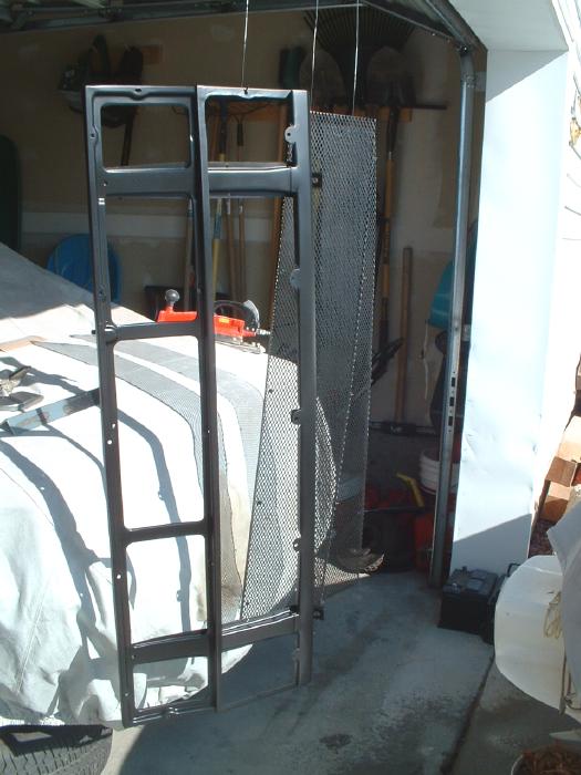

Here's the parts hanging in the sun... I'll fit it together later today and snap a final picture.
Film at 11:00! (IMG:style_emoticons/default/wink.gif)

Eric_Shea   Today's status: Finished off the filler on th...   Nov 8 2003, 02:00 PM
Eric_Shea   Here's the parts hanging in the sun... I'l...   Nov 8 2003, 02:02 PM
