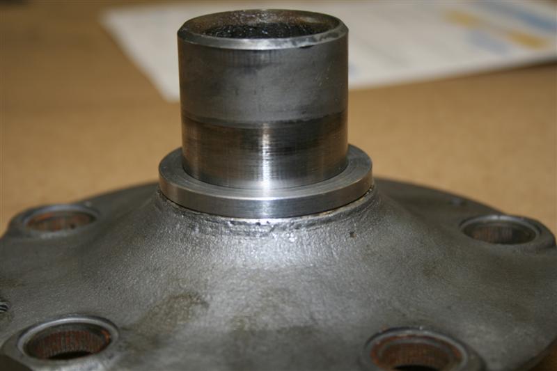

I don't have my car here to get measurements so I am hoping someone has dealt with this. I have 69 911S flanges and stub axles (108mm cv's) that work perfect but the flanges are not hub-centric. I would like to modify a set of 77 hub-centric flanges to work if possible since I have an extra pair.
I know the bearings are wider on the 77 flanges. Anyone know what they did different? Is the flange overall length wider to allow a wider bearing or is the bearing fit area machined further towards the flange itself making a wider fit area? Since I have a lathe, I can modify......
Anyone used these?

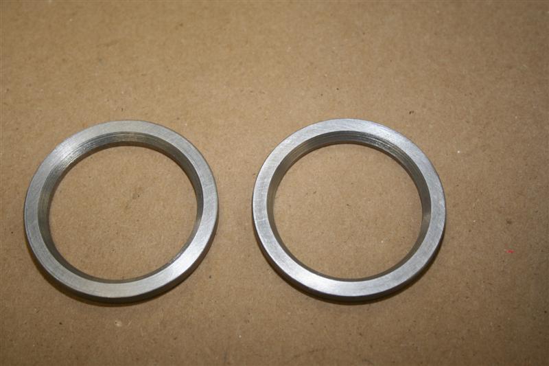

Nate, I have a whole box for you..... (IMG:style_emoticons/default/flipa.gif) (IMG:style_emoticons/default/av-943.gif)
OK, I made a couple of spacers today. All worked well except they require quite a chamfer to clear the radius on the flange. They should be ready to bolt on. Here they are....

PRS914-6   OK, here we go......Flange is off a 1977 911   Dec 26 2006, 02:31 PM
John   Since you made such good pics, I'll just post ...   Dec 26 2006, 02:35 PM
PRS914-6   And this is why we want this type flange. The rai...   Dec 26 2006, 02:46 PM
John   That, and I think more of them are the hub centric...   Dec 26 2006, 02:53 PM
PRS914-6   John, I labeled the pictures. Should be easier fo...   Dec 26 2006, 03:00 PM
Eric_Shea   I only have a pile of early bearings in stock curr...   Dec 26 2006, 03:02 PM
PRS914-6   Eric, if you are right, a simple spacer installed ...   Dec 26 2006, 03:09 PM
Eric_Shea   5mm correct-a-mundo   Dec 26 2006, 03:50 PM

John   I measured one. (Eric, I still have no word from ...   Dec 26 2006, 06:28 PM
PRS914-6   Good Job...The spacer would have to be absolutely ...   Dec 26 2006, 06:31 PM

PRS914-6   Just got an e-mail from Jim Patrick. The later fl...   Dec 26 2006, 11:23 PM
John   Just got an e-mail from Jim Patrick. The later f...   Dec 27 2006, 12:32 AM

PRS914-6   Nate, I have a whole box for you..... :finger2: ...   Dec 27 2006, 04:45 PM
Aaron Cox   oooh! these are VERY SIMILAR to what you need ...   Dec 27 2006, 05:31 PM
PRS914-6   Aaron, if I get 3 or more who want them, I would m...   Dec 28 2006, 01:24 PM

PRS914-6   Guys, I want to make sure we are clear on this. I...   Dec 28 2006, 04:47 PM

PRS914-6   OK guys, I have 5 sets of spacers made for late 91...   Mar 5 2007, 08:56 PM
John   OK guys, I have 5 sets of spacers made for late 9...   Mar 5 2007, 09:18 PM

Luke M   By adding the spacer arent you pushing the hub out...   Mar 18 2007, 04:26 PM
PRS914-6   By adding the spacer arent you pushing the hub ou...   Mar 18 2007, 06:08 PM
