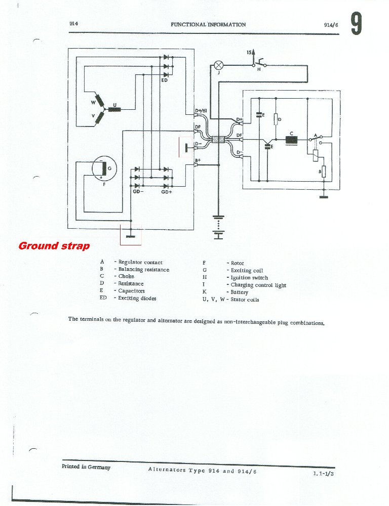

post Jan 8 2007, 08:50 AM
904SVO
Posts: 1,129
Joined: 17-November 05
From: Woodstock,Georgia
Member No.: 5,146
Attached ImageAttached Image
QUOTE(pbanders @ Jan 7 2007, 09:23 PM) *
QUOTE(904svo @ Jan 7 2007, 06:56 PM) *
QUOTE(pbanders @ Jan 7 2007, 03:56 PM) *
QUOTE(SGB @ Jan 7 2007, 04:22 PM) *
Thats what I'm gonna do, just crimp a couple of u- shaped ends on a 10 ga wire and ground from the VR attachment screw to the ground pont on the side hidden behind the relay cover...
It won't hurt anything if you just go ahead and do it, but spend a minute first and check to see if you really have a problem. Check the resistance between the voltage regulator case and chassis ground first - if it's under 0.5 ohm (closer to 0.1 ohm), then the extra ground isn't needed.
If you do find that it's grounded already, let me know. I'd like to figure out where it's getting the chassis ground from.
I'm getting my ground from the grounding strap from alternator to engine case
see post #3.
Look at the following wiring diagram:
http://www.pelicanparts.com/914/parts/elec...lectric_71b.jpg
D- isn't connected to any case ground in the alternator.
Wiring diagram from Porsche Manual shows ground.

Spoke   D- isn't connected to any case ground in the ...   Jan 8 2007, 09:09 AM
pbanders   <good analysis of the system clipped....> ...   Jan 8 2007, 09:24 AM
