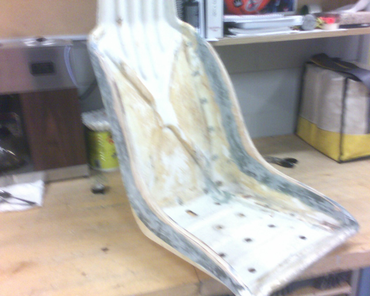

I have never been a fan of the comfort afforded me when I drive my car. I have found that Rabbit or Jetta seats to offer better latteral support and just being made of fabric you don't tend to slide around.
So the winter project started with an old 914 seat I had lying around.
First I built up the side bolsters 2" in the middle, 1" 1/2 way up and forward tapering to 1/4" at each end. Picture # 1Attached Image

I really like the idea of using the factory foam for the side bolsters, but how did you build up the sides and maintain the strength of the formed fiberglass?
